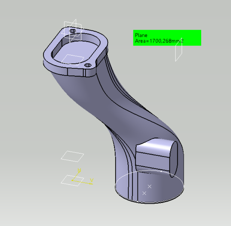

Heres something for fasteddie and me, I know you want a solution aswell to get rid of the small restriction. The market for this pipe is small though since were only two that runs this kind of IC routing
I measured som areas, and the top of the short boost pipe is around 1700mm2, and the bottom of the boost pipe is only 40m diameter (where the turbo normally connects), so 1256mm2. So the restriction in the system needs to increase to at least 1700mm2 to not be the smallest part of the boost pipe system ( equivalent to a 47mm circular pipe). So a 2inch hose would probably be a smarter choice than the 2,5 inch that naturally goes on there, for packaging reasons.
Anyway, i forgot most of what i knew in cad, so its quite a challenge to get this complex part right, it will probably take a long time to get this done. But hopefully it will be wort it with better packaging and less restriction
Heres a draft of where im at, mostly to get the different measurements right.

So reduce to 2†somewhere after the intercooler and it will about equal the inlet of the upper charge tube anyway?
Would fit past the cold housing easier..

A 2 inch pipe is even larger diameter than the smallest area of the upper charge tube, so I think i will evaluate that aswell to see if I can get more space down there. I will have to redo my very special squeezed tube, but it might be worth it. Maybe i will print more pipes to get more clearance with the odd shapes needed.
Its always interesting how much power you can actually push through that 40mm hole we have today, as we have seen. But it will cost you compressor capacity to keep that boost level with the restriction. So if you changed the pipe you would probably be able to get more out of your current turbo.

Oh Catia
This should be good!
note: when designing my tubes, i always check the internal area in different sections. Catia has a way of blending surfaces in such a way that sometimes you get less cross-section area.

Oh Catia
[img]https://rejsa.nu/im/user/1552/2020-12-09-23-32-38_boostpipe.pnb[/img]
Yeah that function really do take some work, one reason im using catia (except for that i worked with it 10 years ago, so I still remember something) is that i have friends who work in it on a daily basis. So its much easier to get help, one of them did actually design aluminum boost pipes for trucks for many years. I think he might be able to sort this out

To me it’s not just the size of the 40mm hole, but that god awful 90 degree step inside of it that just can’t be good for smooth flow..
I have almost thought about replumbing/replacing the entire upper charge tube, but I quite like keeping the original upper charge tube..
Do you think replacing the lower charge tube will make for a noticeable improvement?
I think it may..

Yes absolutely, that step is bugging me alot, its quite ironic that Ive been chasing people with the torch at work for many years to remove ugly designs and focus on pressure losses.. But now when it comes to my own personal engine i have that massive ugly restrictor in the pipe . That ugly step will make the actual diameter that the flow can use smaller than 40mm due to the flow separation that will occur around the edge, a more smooth transition will improve that( if you for example made an insert with a nice bellmouth shape (which is my back up plan), but its still limited.
I could try to replicate it in my simulation model, I would expect the difference for my engine to be smaller. Since I have a larger compressor that works at a lower target boost, so more margins. The more on the limit you are with the compressor the bigger the difference will be. But you would most likely need a dyno to verify it.
