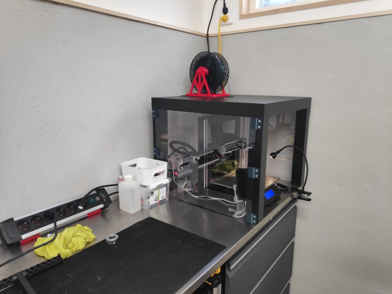

Winter season has officially started!
Im trying to fix my wobbly back wheel, im in the process of changing the stub axel and wheel bearing. Im not sure whats happened really, if i f** something up last time i changed the bearing or if im just had bad luck.
Bought my Prusa in kit form aswell, its was fun to build together with the kids. After setting the z level it just worked perfectly out of the box, its why I payed extra for a Prusa, and of course that I rather support them than the chinese . Only thing that i think i will have to adjust is the filament sensor, since the autoload function doesnt seem to work anymore.
Washed my car for the first time in a long time, went to a indoor do it yourself spot, its winter times here.
No more long braker bars, nice powerful tools make it sooo much easier.
2 rolls for the kids and 4 for me, really interesting to try PC-blend, which should be among the best materials you can print yourself for high temps.
Made a nice enclosure aswell, no more garbage built tent like I had before.

looks really cool, keep saying that i'll make myself an enclosure but always get lazy and keep ordering PETG instead of PA12 or PC-blend.
I dont even dare to show my temporary one, looked like a pile of old scrap boxes and other rubbish
Normally I have it quite cold in the garage when i dont do any work there(its easy to just start the heatpump with an app before you go out for some car work), so an enclosure is nice to have for all kind of materials to keep a decent temp. I noticed the prusa printer doesnt even want to start up the heating process when the bed is 10degC and lower, its a safety feature because it thinks the sensor is broken

Your enclosure is sweet! Mine is currently in a temp controlled room so I have held off doing an enclosure. When I finally do it I was thinking of temp controlling it with a small fan to keep it constant without messing with general air flow around the printer which might be difficult. We shall see
