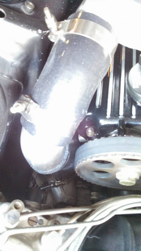

A little hard to see, but this is detail showing the connections from the stock 931 turbocharger outlet to the charge cooler air inlet. It is simply two 45 silicone couplers with a 90 aluminum elbow in between. Pretty straightforward to connect.
