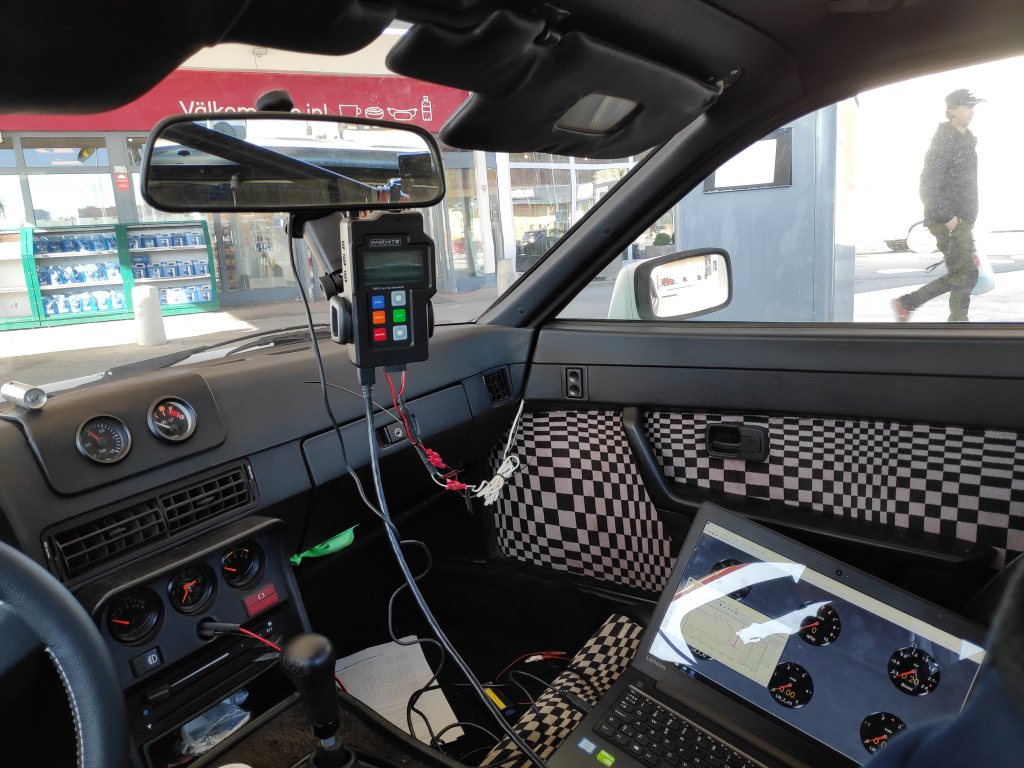

I halso started connecting up my LM2 wideband logger to get some data when the car is out. Theres still snow here so now fun driving yet

This weekend it was finally spring and dry roads, so i had my season premiere and had a day on twisty country roads with a friend and his renault 5 (honda k20 swapped). We both had some logging work to do and also really wanted to drive after so many months without. As normally you always forget how fun the car is, and how well it goes on boost
I had some issues with the logging and a very noisy boost signal, i have to redo some wiring to get try to minimize interference.
Anyway, as i already had assumed it runs really rich. The AFRs are stable and are the shape of the map looks good. But about 1 point more fuel than i would want, about 11,5 is the target. IF this was my chosen boost level i would most likely tap my wur or bleed wur signal air to limit boost enrichment. But now i will first raise boost to 1 bar and see how it runs there first before i decide on what to do next. But the car works well and is so much fun to drive!
