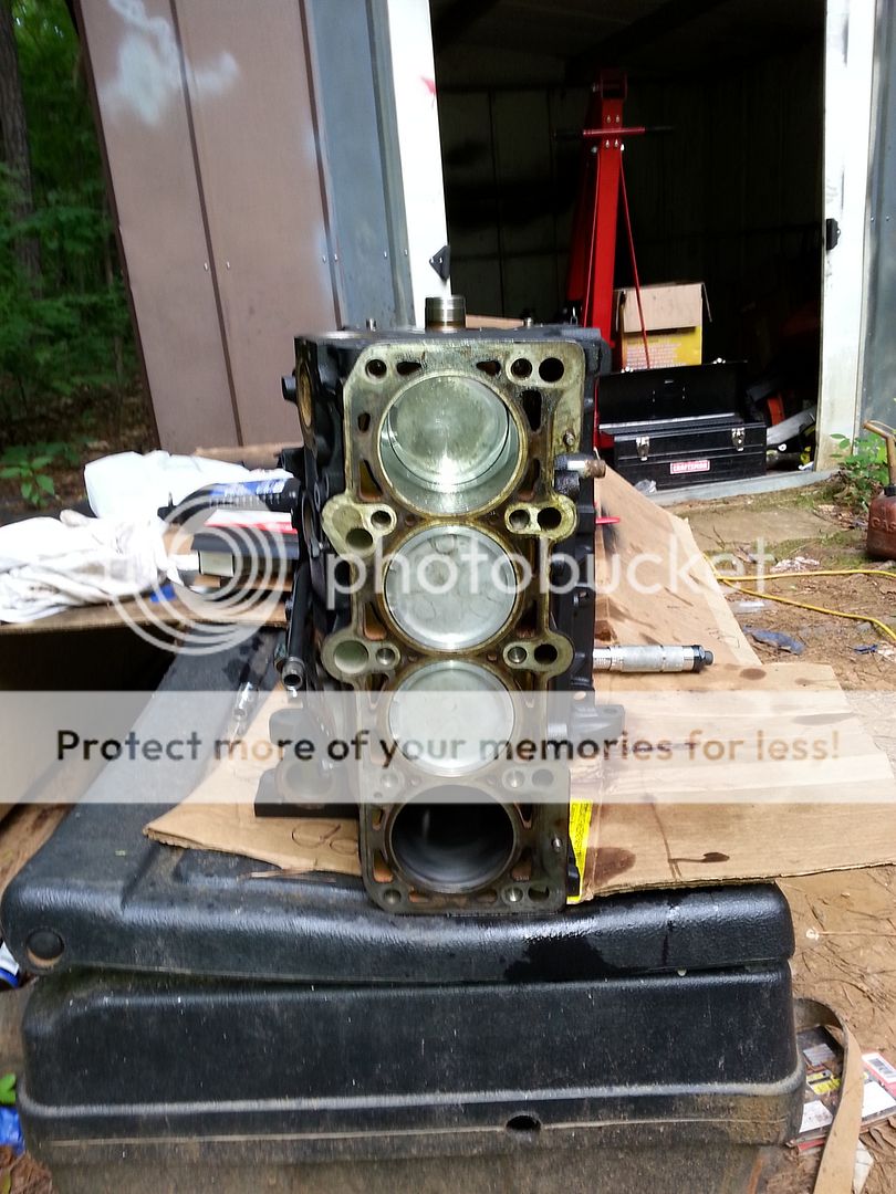

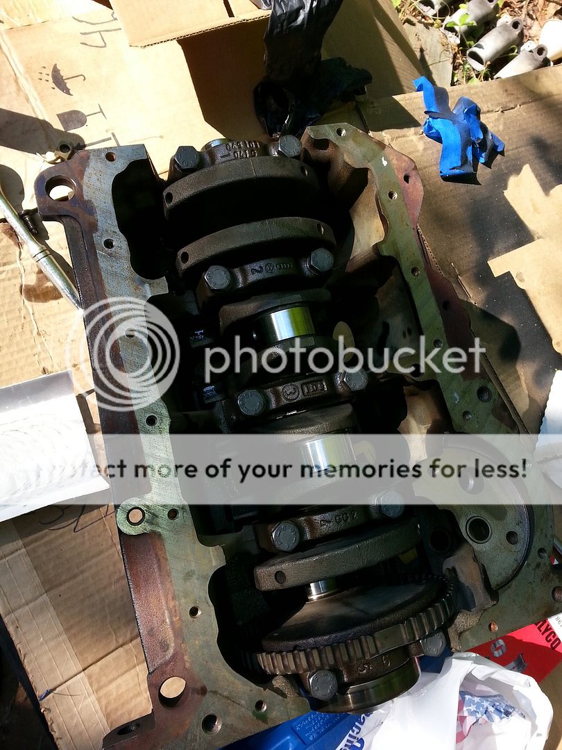

Painted the block.
Installed the crank.

PostPosted: Thu Jun 11, 2015 12:18 pm    Post subject: Reply with quote
Looks great!
Glad to see you got the engine back from the machine shop so that you can finally make some progress!

Progress has been slow due to working 56 hours a week. I did manage to install my crankshaft, rods and pistons. I also made a shim/mounting bracket for my slave cylinder.
