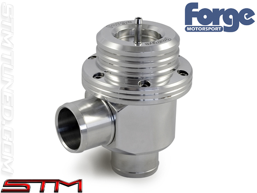

As I am running a 944 turbo I use an axternal recirculation valve/ BOV (from Forge).
On the internet I see two differant way's to mount it (boost in/out), is this the correct way or doesn't it matter ?

Pressure in from below. Pressure out at the side. Vacuum/boost signal above. Forge say do not reverse the flow. Is that a pic of your forge BOV ?
Try it with and without BOV. They aren't always needed.

ok, thanks so the pictue is telling it wrong
The picture above is not my recirculation valve but it looks simular, this is the Forge I use:
