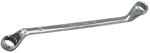

Clbmkr1 wrote: | Mounting bolts are hard to get to. Getting them back in will be a joy also. |
Deep offset box FTW:
