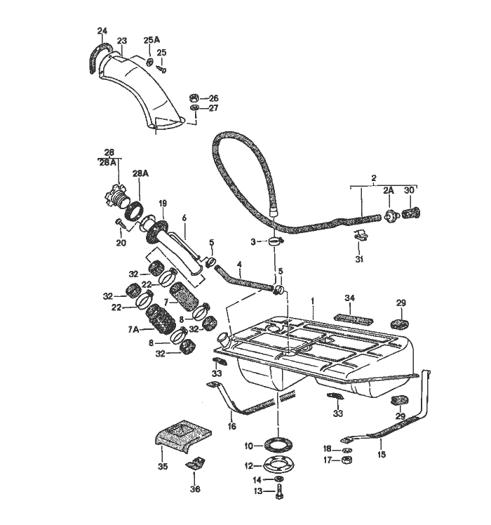

Definitely the one-way valve or the bleeder value should be checked.
Generally speaking, the "whoosh" would be greater as the temperature increases the the amount of fuel decreases. It's quite possible the fuel ventilation valve or bleeder valve (cf., 2A in 1976-79 924 diagram below) is stuck or installed backwards.
The loud "whoosh" is common in 924s and 944s, but it should be corrected.

That 2a in the diagram appeared to me to be a one-way valve, and I was pretty confident I installed it in the same orientation it was in when I took it off.
I don't recall which way that was, but given the behaviour, it sure seems like it's installed to allow air in the tank to replace the fuel that is drawn out, but does not allow air out to account for thermal expansion of the air.
How is the system supposed to be configured?

Actually, as I understand it, the fuel ventilation valve's function is not specifically as a "one-way valve" (which I should have pointed out in an earlier post in this thread) since it acts as a kind-of two way valve depending upon initial conditions: (1) when the pressure in the tank is too high the vapor is vented to the charcoal canister., and (2) as the fuel leaves the tank, the ensuing vacuum can draw air back into the tank. So just to clarify a bit, a little "whoosh" is normal on occasion when removing the cap.
There's an excellent discussion with outstanding images and diagnostic tips on page 3 of this thread of the Pelican Forum Gas fumes? Tank leaks? Read this.
