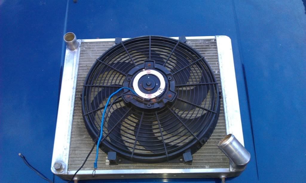

To keep the engine cool I managed to obtain this - 4 core, 70mm thick Pace radiator with a low profile Kenlowe:-
1979 UK 932
