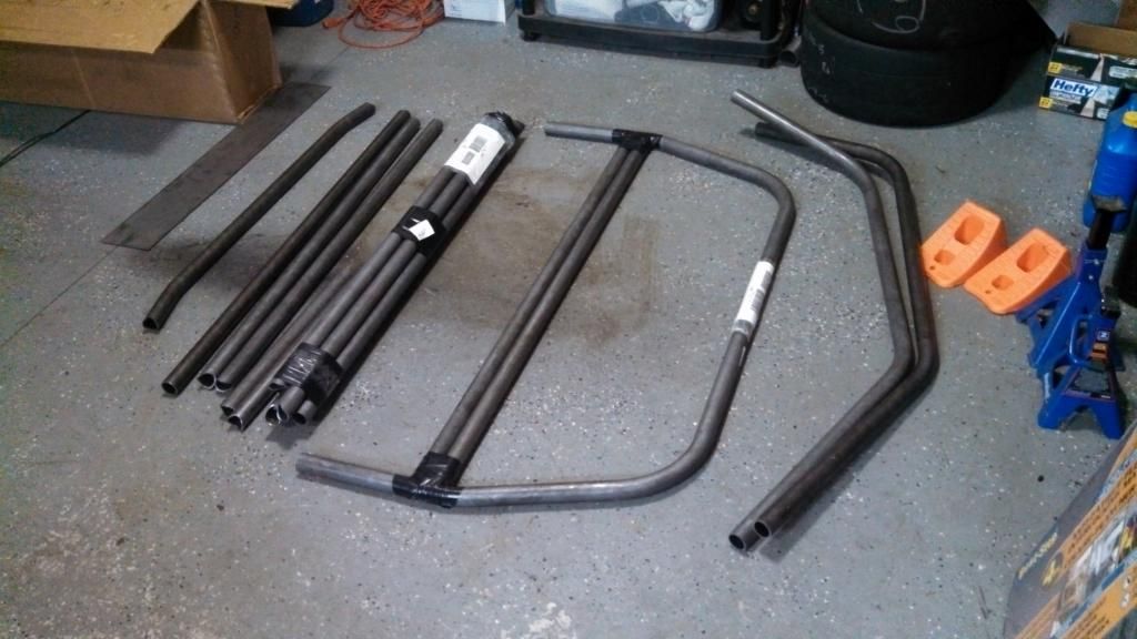

What brand cage did you buy? I'm thinking of a Hanksville for my car, and having someone in Phoenix weld it in.
Ian89C4
Joined: 01 Apr 2011
Posts: 544
Location: North Carolina
PostPosted: Sun Feb 03, 2013 12:24 pm    Post subject: Reply with quote
Grenadiers -
I used Roll Cage components. Jim was extremely easy to work with, and the extremely reasonably priced. He primarily does stuff for 24 hours of lemons, but can easily make them for any racing series. I am going to have a local fabrication shop weld it in for me....best to leave this stuff to the professionals. PM me if you want to pricing info on the cage. I will post pics once it is in.

Ian,
Before you have the cage put in, read the SCCA General Competition Rules which has pictures or cage requirments (materials, diameters, thickness, pads, bracing, and mounting). Give that to your welder to ensure that mods won't have to be made later.

That is my plan. The march date is an open track day with around 4 hours of total track time. I did not want to take the car out to a race / TT / or anything like that prior to figuring her out. All of my previous experience has been in a 911, so I will have to figure the 924 out and how to best drive her. The biggest thing that i believe will be a sticking point is the braking...no where near as big of calipers as the 964, and no ABS....I am using lightly used R Comps for the first go around as I am sure that I will flat spot them a few times before i figure her out.
fifty50plus -
Yup, I have a copy of the GCR next to me as I type this. The cage is 1.5 x .120 DOM (up to 2700 lbs - playing it safe - ). It has the X in the main hoop and crossing door bars. The company that i had build it supplied enough gussets for every joint. I also have the GCR section printed out for the guys I am going to have weld it in so that they do the appropriate type of welds and my anchor plates are not over 144 square inches...although I don't think I could even fit that much on the weld points for the car.
