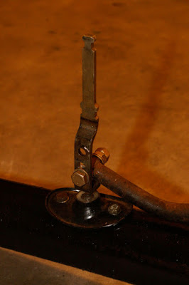

Modifying the shift lever- The first step is to modify the Audi-based shift lever.
- Grind off the weld that holds the pin on the stock lever, and punch the pin out.
- Using a punch, mark the location for the new pin at about 3/4" or 20mm below the original pin location.
- Drill a pilot hole first, then enlarge the hole using a 3/8" drill bit.
- Use a round file to open up this hole just large enough to fit the shoulder of the M10x55 bolt.

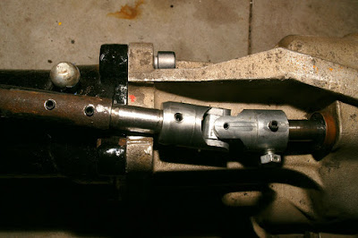

Clearancing the U-Joint- However, we're not quite done yet. This particular u-joint is a little long, and when the G31 input selector shaft is in the foward-most positions (Rev-2nd-4th), the barrel of the u-joint can intefere with the flange (where the torque tube mounts to the gearbox) as well as a cast-in taper on the gear box itself.
- You will need to shorten the barrel of the u-joint that attaches to the solid connecting rod by about 3-4mm.
- You will also need to grind a taper onto the bottom portion of the barrel to provide clearance for the u-joint above the aforementioned taper on the gearbox housing.
- When you're done, your modified u-joint should look something like this:
- Here is a shot showing the clearance issue described above when in 4th gear (note the front-to-back clearance at the flange, and the top-to-bottom clearance beneath the u-joint barrel at the taper on the gearbox housing):

- Your shift lever should already be attached to the torque tube from before.
- Insert the M10x55 bolt through the lower hole you drilled in the shift lever.
- Add a flat washer.
- Slide the shift rod over the bolt.
- Add another flat washer.
- Add the spring washer.
- Hand tighten the M10 nut against the spring washer.
- Screw on the locking nut and tighten lock it firmly against the other nut.

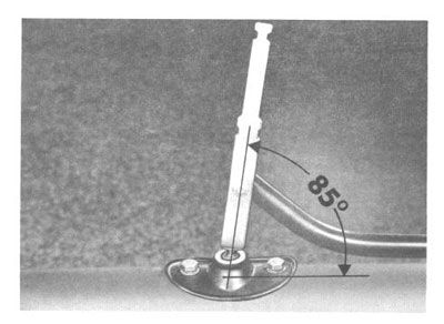

- Slide the saddle on the torque tube forward or backward so that the shift lever sits at approximately the 85° angle depicted in the FSM, and torque it down:

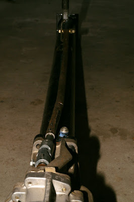

Should look something like this when finished:
Neutral:
Reverse:
1st Gear:
2nd:
3rd:
4th:
5th:
