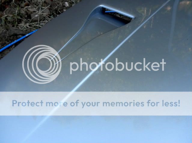

PostPosted: Fri Aug 13, 2010 3:19 pm    Post subject: Reply with quote
I didnt use any..yet. I dont there being any issues with
miss matched panels at all. Check it out.

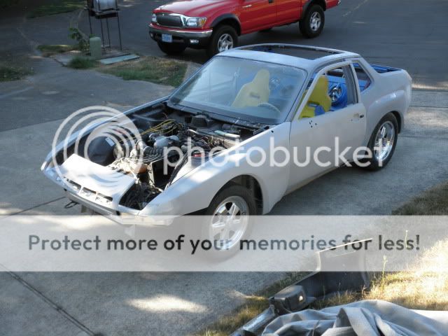

Look what I did in my driveway.
Mount a license plate upside down on the orange bumper? Kidding, kidding.
Looks great! What kind of spray gun did you use?

Joe that is some great work there! Are you worried about the paint not matching since you’re doing it in pieces? Just wondering.
1981 924 Turbo
PostPosted: Fri Aug 20, 2010 1:02 am    Post subject: Reply with quote
Blurred line no im not cuase guy at my paint store ( i was told) .. . i shouldnt worry either because its a very basic silver to mix up. Im really stoked (ha
now theres a word- stoked !) bout how many shades it has depends on the light.

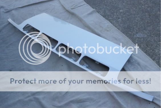

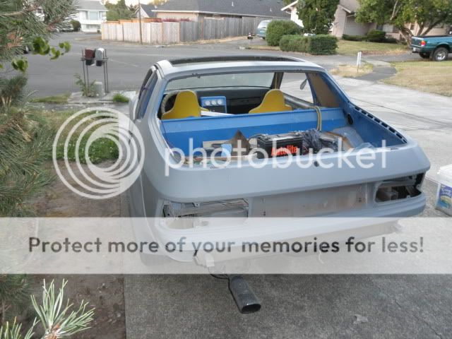

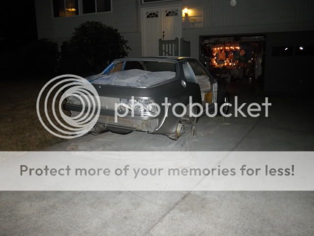

Look at this nice huh. I did alot in 5 hrs I sprayed sealer on the tub and doors and put on base coat and cleared it all. I think it all matches pretty good.
Heres the tub in paint........ base first.
Now clear....
and a fender set in place...
The doors (not the rock band).
Well then it got dark.
